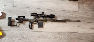

7mm SAW Build
806guns
Build specs
R700 action
7mm Saw II 24" Preferred Barrels Remage 1:8 twist medium palma contour
Indain Creek Design Chassis
Riton 3 Primal 3-18x50 30mm FFP
Total wieght of rifle is right at 12 lbs
I will be shooting 162 eldm or 168 vld this evening. Main plan for this rifle is a hunting/comp rifle. Speeds should be slighty faster than 7mm08 and better than AI version. Plus no fireforming with Alpha making brass for WTO
Posted a picture of Alpha brass next to 308(right)

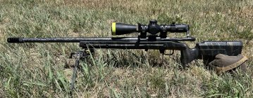

I just finished a 7SAW build using a Proof carbon 24" barrel on an Impact 737R action and am pleasantly surprised at the velocity from a short action / non-magnum bolt face. Alpha head stamped brass with Hornady 162 ELD-M over Varget and Federal 205M primers. So far only have 34 rounds down this barrel but shows promise before finishing the break in.
41.8 grains Varget = 2,777 FPS / ES = 3.0 / SD = 1.2 / .341" 3 shot group.

Build specs
R700 action
