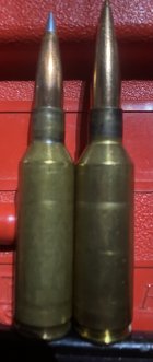

I jump the 190 A-Tips considerably. I realize the Hornady podcast guys don’t believe they are seating depth sensitive, but I think they need a long jump for best accuracy. Also, jumping bullets keeps the peak pressure lower. I am not giving up necessary case volume because a saum is capable of holding plenty of powder to either open its primer pockets, or blow up bullets, and so you can’t use it all, anyway.
You can see the OAL on the left side is shorter, despite their being longer. Does seating into the donut hurt accuracy? For me, no, but I don’t do things that exacerbate donuts through brass migration, like turning or trimming necks, nor do I ream the throats, so that may not be universally true.
Also, I use body dies as opposed to full length dies, so I am altering the necks as little as possible. I size down the top of the neck only, which gives sufficient neck tension to reliably extract a loaded round while minimally working the brass.
