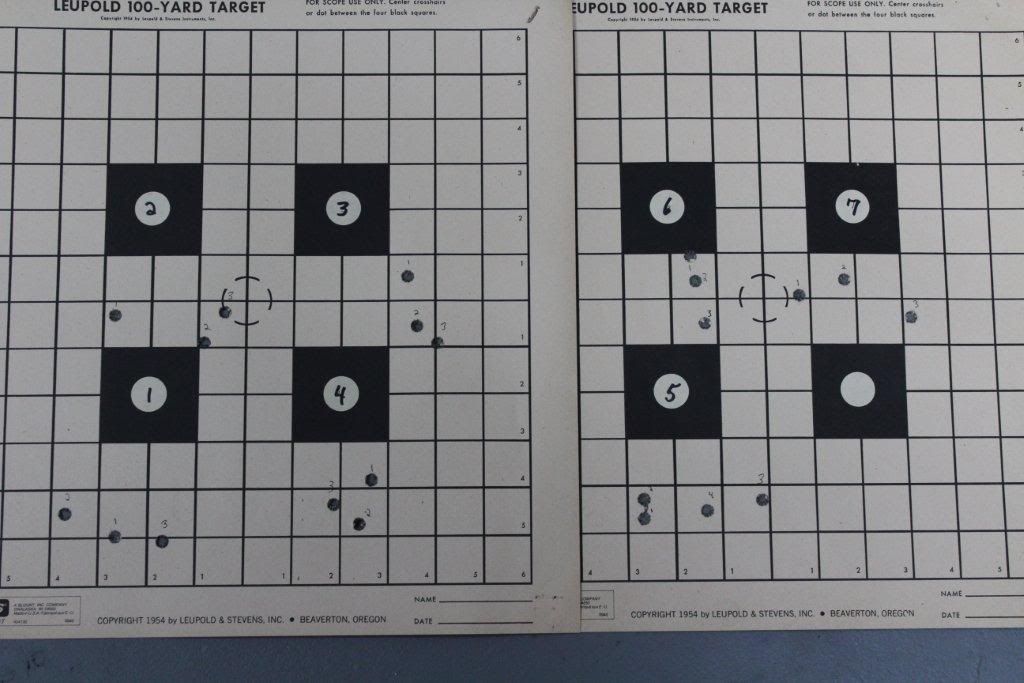

I started working up a load for my new 7mm SAUM this morning and would like some feedback and ideas.
The basics are: Remington 700 LA; Kreiger #5 5R 26"; Leupold 6.5-20x LRT
Reamer has .188 freebore. OAL 3.045" .020" into lands
The loads: Reloder 25; 180 VLD; Nosler brass; 210M primer using the following charge weights:
1 - 59.5
2 - 60.0
3 - 60.5
4 - 61.0
5 - 61.5
6 - 62.0
7 - 62.5
I shot these groups round robin so shot 3 for load 5, 6, and 7 were the last three shots. The wind had picked up slightly from the right. I have no idea why the shots landed to the right.
Test done at 300 yards. Temperaure 40 degrees. No wind.
Another bit of information: 61.5gr clocked 2760 fps (it is the only load I had extra rounds for).
Dan

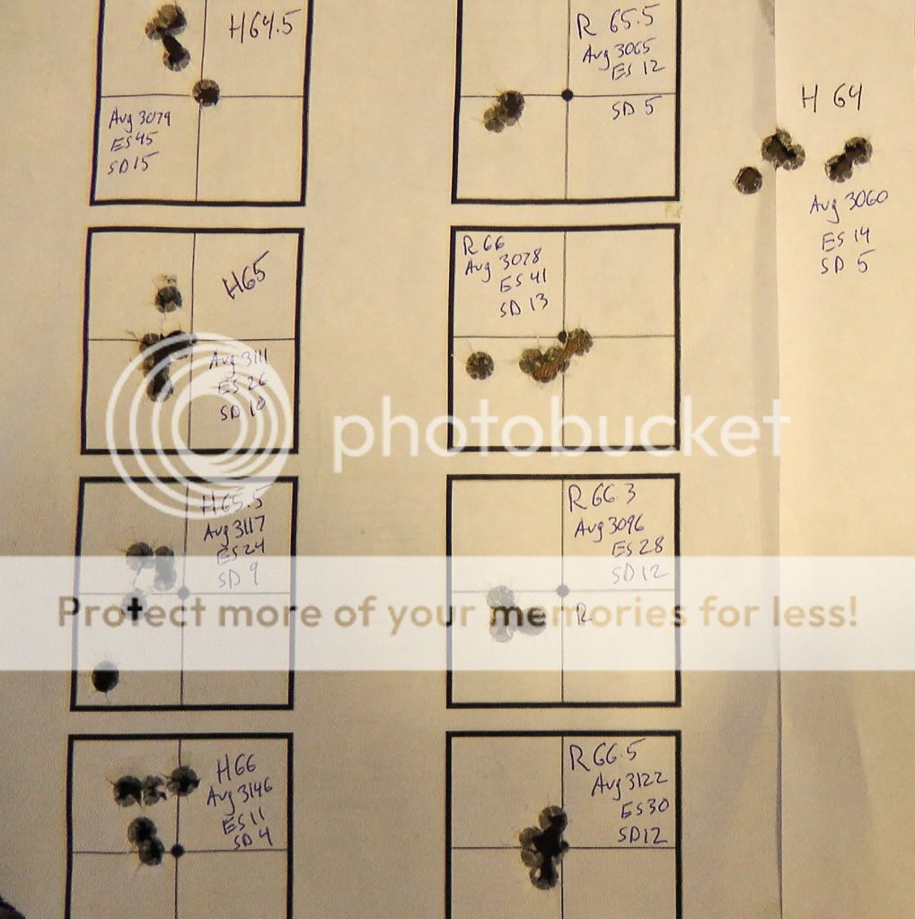

Bighorn short action
28 inch barrel
168 Berger +.010 jammed
Rem brass
CCI-BR2 primers.
This is a target from my breaking in my barrel. All 5 shot groups
R-is for Retumbo
H-is for H1000
I have both Retumbo and H1000 (and most others except H4831). I will try them. I also have some 168 VLDs.
It looks like you rifle likes Retumbo. From how far were those groups fired? What is your OAL?
My rifle likes RL 25, but it seems to be only in the lighter end of the charge range. When I broke in my rifle, I fired a .219" 100 yard group with 60.0 gr in Remington cases. I doubt it was going 2700 fps (my chronograph is on the fritz). I switched to the Nosler cases and ran another series. 61.0 gr went 7/8" at 300 yards. It looks like the rifle wants to shoot. I think it is pretty good for a sporter.
I wonder if there is a higher node. At 62.5 gr of RL 25, the groups were poor, but it looked like I could take another 0.5 to 1.0 gr. I am not sure it is worth the try. I may be better served changing powder. I would like to find accuracy and 2850 - 2900 fps.
For the 180s, which powder would you try first, H1000 or Retumbo?
Thanks
Dan

dmoran said:
dzelenka -
When reading your threads title "7mm SAUM, 180 gr VLD ladder test" I was expecting to see ladder test results. But your tests presented are "round robin" group tests.
No problem with your choice of testing, just wanting to point out that it was not ladder tests.
Good Luck with your load developments !!!
Happy Shooting
Donovan Moran
Actually a ladder test on these loads wouldn't have proven anything, the groups are all in the same place, just varying left and right. This is the reason I don't do laddr tests.
