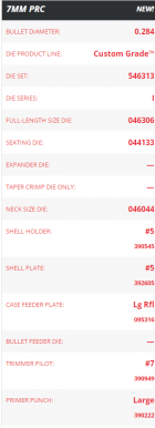

Was on the phone with Redding and they do have dies but there is no catalog numbers yet. Midway doesn't have and Brownells hasn't gotten back to me yet.

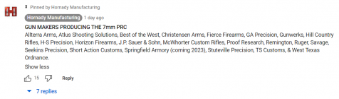

BTW: here is a list from Hornady for the gun makers they claim will be offering 7 PRC now or in the near term.

Redding told me that they are making 7PRC dies currently. However, there is no stock number yet and you must place an order for their custom dies through a stocking dealer.
