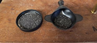

I pulled down the last box of the Match ammo and the average charge was about 72gr of what looks to be Staball HD. The bulk density was very near it but not exactly it so I can't be sure. If it is Staball HD about 3 gr over published max load based on Hodgdon's website. I dropped the charge down to 69gr and shot them without issue with mostly sub moa accuracy.

Yeah it looks very similar to staball hd but obviously it could be any number of ways different.
Staball hd on left, unknown pull down on right:
