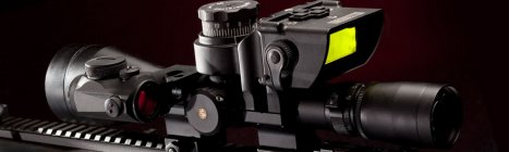

Nightforce 8-32x56 NSX scope NP-2DD reticle
Barrett BORS ranging system
