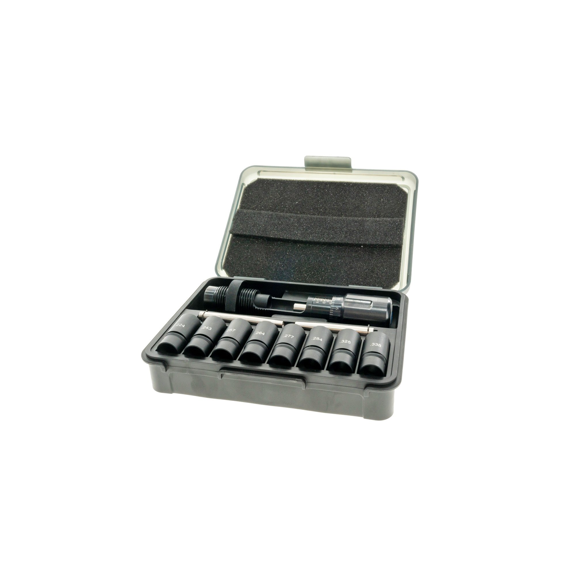

Probably not as good as a Wilson but this die really surprised me. Never was a fan of seating dies that only used a collar for bullet alignment but for some reason this die works. If the case run-out is good it will generally keep the BRO under .002 or better. JME
Thanks for this; new to me.
