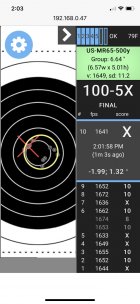

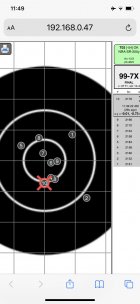

Here is how 24.0gr of Tac at 2.25 COAL shoot out of the gas gun and the single group is out of my Bartlien barreled Tikka. Same load.
twice fired LC, CCI 41s.
I didn't believe it until I tried it with a service rifle AR, but adding a light crimp on the necks with a Lee collet crimp die tightened groups up with 77gr Sierras (and Noslers) and 24.0 gr of TAC at magazine length. Folks told me that somehow TAC shot better (and cleaner) with a crimp and I was skeptical until I tried it myself. Granted, this was to hold X/10 ring on a NRA sling target.
I would do the same when I was loading shortline ammo. 24.0 grains of Tac with a light crimp. I noticed lower SD's when I crimped.
