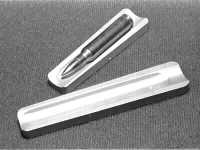

I've got the screws coming, but now if I could just find a single shot adapter that is glued in the action, not a follower because there is no magazine at all. Or if someone has some clear photos of one I could make my own.
Hmmmm. These don't have the "custom hand crafted look" that I achieved with my scrap of bamboo flooring:rolleyes:, but they look like a pretty practical way to go. I think they're gonna get some of my money. jd
