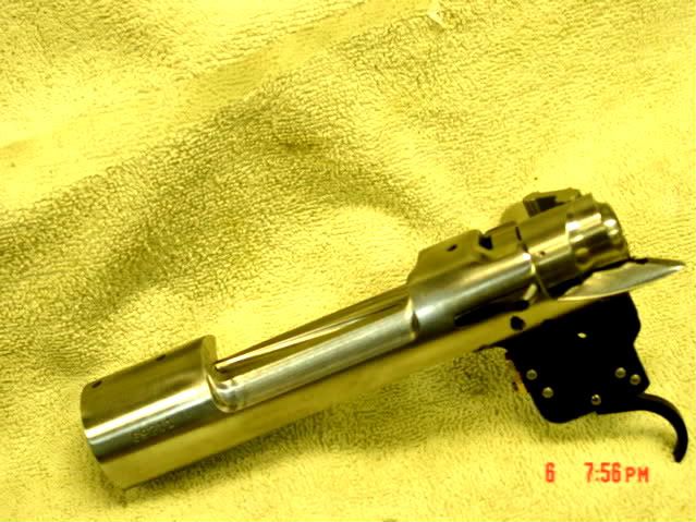

You can blueprint a Remington action the right way or you can half azz it. Below is one done right and even with help from Buddys and gunsmiths prices on parts and doing some of it myself, I have about $850 in it. That includes the $200 I payed for the receiver. It was not a smart move on my part.
It is now a 6X47Lapua hunting rifle for my 19yr. old Grandson.
Butch
