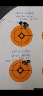

If memory serves me right 64.5grs of H1000 was a warm load that would exceed 3000fps.
I'm sure I reduced that away from pressure signs.
