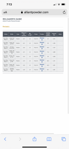

Getting ready to start loading the 145 lrx. Anyone have any powder suggestions or pet loads. I have rl26 imr7828, h4831sc and rl 22. Wanting to try to rl26 first but not finding much data thanks
I tried them when they first came out with H1000 and RL26. Both shot around .625 . I did notice when I got to the upper end of RL26 it started barking pretty good.
Thanks any idea where a good starting place would be for rl 26
For a bullet that light I'd try a faster burning powder. My vote would be Reloder23. My Sendero loved RL23 and 150gr Ballistic tips. I'm afraid Rel26 would soot up the bore and foul out too quickly.
Of the powders you have try 7828 or H4831SC.
I would start with 4831 and see how that works out. I load 140 barnes for a friend and im using imr 4955 with good results. Heres data from the hodgdon book.
