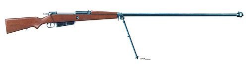

jr600yd if you click on the pictur you can see the breack they used. It was reported to have reduced recoil 60%, and was said to be similar to that of the standard infantry rifle.
