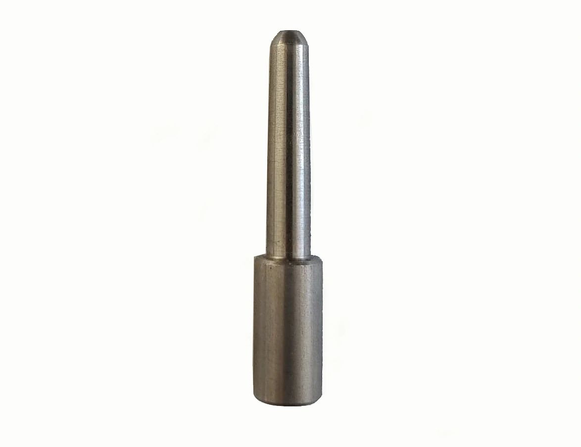

Hey All,
Long time listener, first time caller.
I've been reloading off and on for 15 years but never reloaded any wildcat rounds and I've never messed with expanding mandrels. Usually just loading a lot of 6mm variations and around a thousand rounds of 9mm every month or so.
Can anyone recommend me a mandrel body and mandrel to neck up 6.5PRC brass to 7PRCW? Start with a .282 expander mandrel?
Other than necking up, is there anything else that I need to do? I was thinking necking up then running some light loads first to form them correctly? Do I neck up, then size in a 7PRCW die immediately after? I'm lost.
Any tips and steps are much appreciated.

Here is what I have used necking up Lapua 6.5PRC to 7mm.
A touch of Imperial or Ballistic Die Wax to the case mouth and presto!
7PRCW cases ready for a light neck turn {even though I have a No Neck Turn chamber} it does not hurt to just skim them and do the very slight cut into the neck/shoulder junction to help prevent Doooooughnut's {:~)
You will also need the body die to hold the mandrel but that is okay as I would suggest that step after sizing anyway and you can get a range of sizes to give you just the “right” neck tension… OR you can buy some ADG 7-6.5PRCW cases ready to go…

I have a friend that necks up Lapua 6.5 PRC Brass he uses a 21st Century expander mandrel then turns the brass.. he has a .316 neck chamber.. then he shoots.. NECK UP MANDREL
Exactly as I did for my Lapua 6.5PRC brass… 21st Century Neck Up mandrel, skim turn and touch into the neck/shoulder to relieve a bit of thickness there and help stop donuts forming.
marchx said that he did not have access to the 21st Century neck-up mandrel so I suggested that he just use the 7mm “turning” one that he had and use lube on the inside of the case neck and a touch on the mandrel and go slowly.
With the neck-up that I used I only lubed the neck opening a touch and it was easy, peasy..

Thanks everyone for their responses. It's been very helpful. So far I've purchased 6.5PRC Brass and Forster FL Bushing/ Micrometer Seater 7PRCW set just now and while I appreciate Micron and 21st century reccomendations, i'm trying to find a more wallet friendly expander body and mandrel. Spent this week buying all the new items for a new fclass rifle build and the wallet is overheating.
Would it be foolish to get the Cortina 6.5prc mandrel body and the .2825 mandrel vs the .2820 mandrel? Suggestions are appreciated!
Thanks again!
any thoughts if this will have any issues? pma expander die body and a 21st century expander mandrel .282
since the mandrel body is universal and not for 6.5prc i don't think there is support to ensure proper alignment when i bring the brass up to the mandrel, i figure if i'm careful bringing the ram up to the die that it shouldn't be a problem.
The Cortina 7PRCW Mandrel Die is a good buy for your final Neck sizing after the sizing.
but to neck up the brass all you need is a .284 Mandrel as the brass will return back down enough to
hold your bullet and get them fireformed if you want to shortcut and just get your brass ready for your
final load development....many ways to skin this cat. As far as the donuts just seat your bullet above them and don't worry about it...my 2c

I ended up getting the 21st century mandrel body and a .284 mandrel.
For seating/sizing, I purchased the Forster Bushing/Micrometer-Seating set for 7PRCW. I appreciate the tips, I don't even know what a donut is (short of just reading a few lines about it, nothing definitive), so I guess i'll travel down that road once the donut possibly presents itself.
