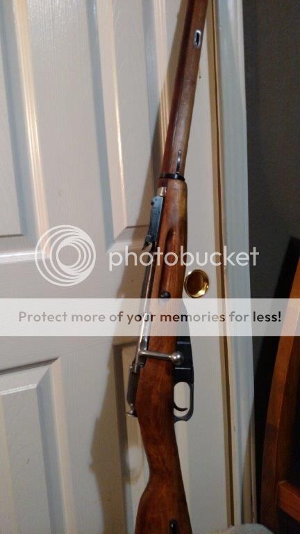

The rifle came in on Wednesday and I must say that I am not too pleased. It was suppose to have a hex receiver and it doesn't plus there's a big hunk of wood missing on the front of the forearm not too mention a lot of dings and dents all over the rest of the wood. The barrel doesn't look bad and the bolt seems to work nice and easy. The trigger is not as bad as I expected. They described these rifles as very good to excellent condition and I have to disagree, more like very well used in a combat situation. I will slug it tomorrow to see what size of bullets I need to reload with and I'll also try and get it out to the range as soon as this rain and wind stop. As of right now, I'll probably never buy another gun from these guys. Here's a pic of the damaged wood. You be the judge.
Dang, that stuck looks rough. How is the rest of the metal? Who did you order it from? Hex receivers usually cost more, maybe you can return it since you didn't get what you ordered.

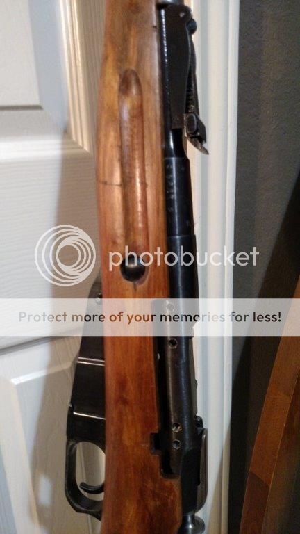

I just picked a PU Sniper sans scope and mount from samco:
I went with one of these because I wanted to use a modern scope without having to drill holes, get a bent bolt or mess around with an extended eye relief scope.
I added an accumounts base that screwed right in to the pre-tapped holes. The base came with split rings that allow a 1-inch scope. Added a Vortex Diamondback HP so we'll see how she shoots next week. Trigger pull measures at 3.5 lbs vs the 6.5 lbs of my standard 91/30.
Yours looks brand new compared to mine. I could clean it up and fix that stock if it shoots good, I didn't really buy it for a collectors item, just to shoot but as their description as very good to excellent goes, they lied . As far as returning it I know for sure they wouldn't refund me the money for shipping and the background check which both cost me about half of what I paid for the rifle. Oh, I got it from Classic Firearms.
