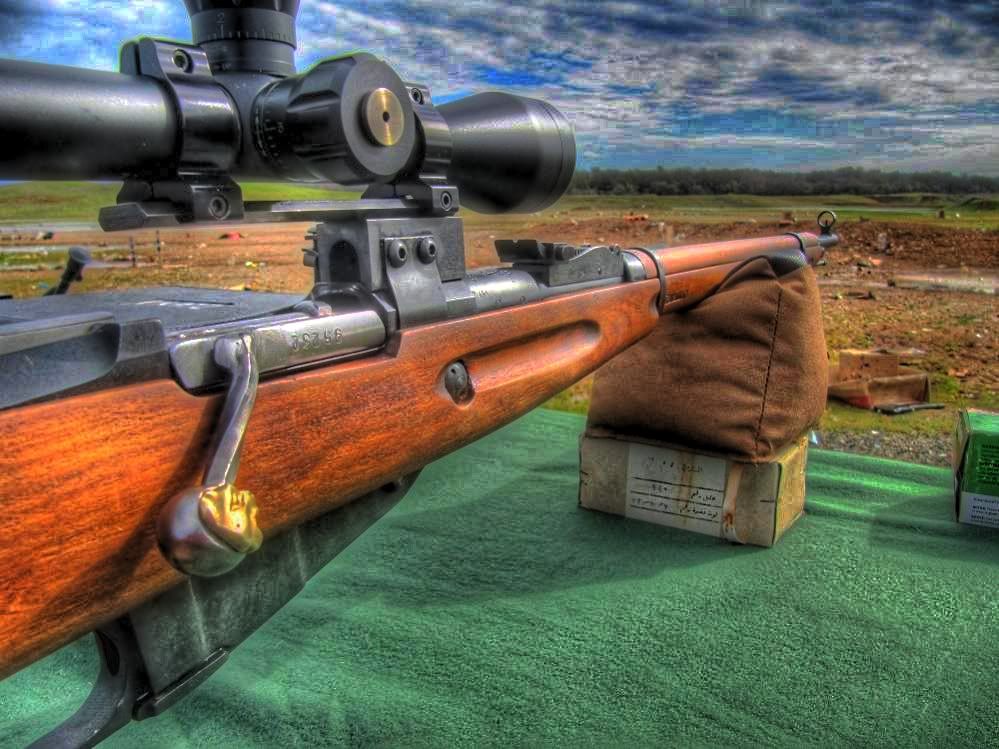

Thread needs more pictures. here is mine. :)
1927 Tula Hex jmeck scope mount. (doesn't require drilling) and a finnish two stage trigger. First gun my wife has ever shot and she hit a pepsi can at 50 yards with the iron sights on her first shot. And has never let me forget since.. :o
