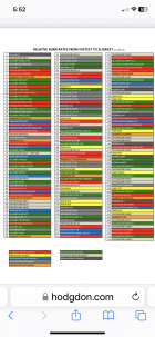

Just from my experience N555 is slower burning powder, it is closer to H4831SC than H4350
Mine is the opposite. In a smaller cased 7mm, the 7mm-08, it was similar to H4350, if anything a little faster burning.
http://www.targetshooter.co.uk/?p=3683
In Viht's max charges, N555's are very close indeed to N160 often exceeding them slightly in smaller cartridges, but drop a couple of grains lower in the larger numbers. Vihtavuori, and hence in both published burn-rate charts and QuickLOAD Ba values, is a serial offender in showing its powders as being 'quicker' [edit: that should read 'slower'] in relation to others than they really are. I long ago concluded that N160 behaves as if a little slower than H4350 and is not an equivalent to the 4831s that burn-rate charts show it to be. That would again put N555 close to H4350.
I've switched over to N555 from the 4350s (no longer available on the eastern side of the Atlantic) in an F-Class 300 RSAUM for 185/200s. Loads are much closer to those for the 4350s than to H4831.

In my testing N555 was around 1.5-2gr more than 4350 in my .300wsm and 6.5-7PRC to obtain equivalent competition velocities, pressure does not seem to build as quick as 4350.
In my 7-6.5 PRC Imp 40: ADG Brass.
N555. 55.3g. 2922 fps.
RL16. 53.2g. 2929 fps.
H4350. 53.8g. 2929 fps.
N160. 54.7g. 2927 fps.
RL23. 55g. 2928 fps.
Not sure if that helps anyone or not.
