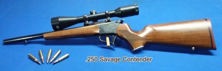

The platform has afforded me the opportunity to explore a lot of wildcats.
Here's a 6x223
and after I gave 'er a jacket.
