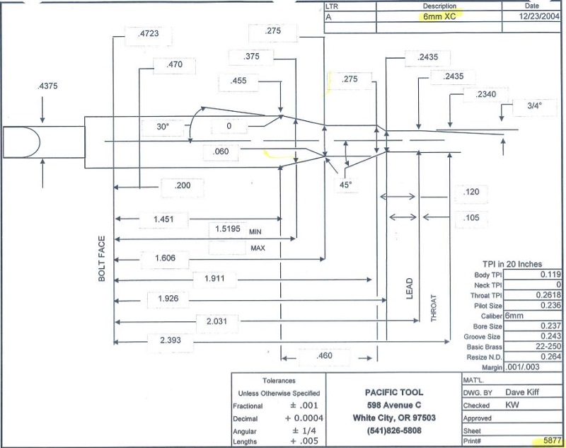

If anyone beside me is interested, here's the reamer that Criterion uses for 6XC barrels.
