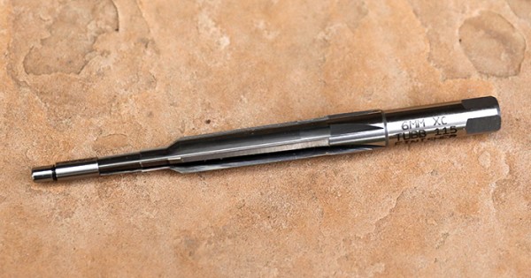

Or you can get the reamer (in stock), right from D. Tubb.
It is set up for the 115's, so is a bit longer in the throat than I prefer for the 105 class bullets, but...
