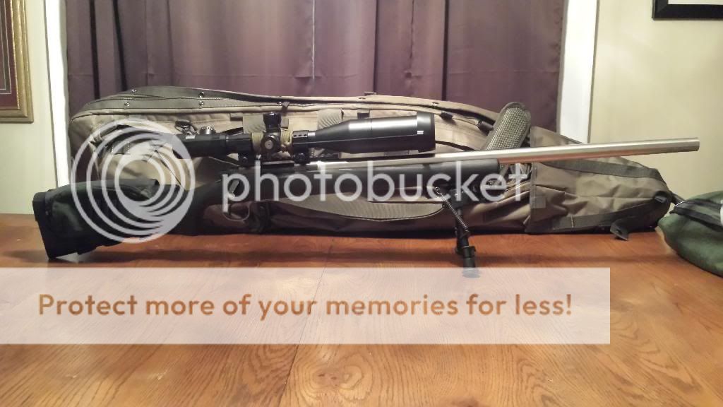

Few details on the original rifle, and the built it became.
Remington 700 SPS Tactical .308, 20"barrel 1-12tw
Hogue Factory Stock
Bushnell Elite Tactical 3-12x44mm
After shooting the above rifle for about two years, I realized it was time to upgrade to take the game more seriously. Below is what magic he worked for me.
Dan Caudill from Eastern Kentucky
Trued and squared Remington 700 action and bolt face
HS Precision fitted stock
Krieger MTU 1/8tw #10 barrel cut and threaded at 26"
Large recoil coil
Timney flatbase trigger
Action/lug bedded
Raised stock pack
Harris swivel bipod with podlock
Weaver 20moa Base
Burris medium tactical 30mm rings
New Bushnell Elite Tactical 6-24x50mm FFP
Norma 6XC Brass
Berger 105hyb
.010 off lands
3050fps MV
40gr H4350

Lookslike a really nice rig. It shoots really well. Give us an update as you do more shooting with it.
Very nice looking rig, and you HAVE to like those targets. Congrats on what appears to be a successful build. :D WD
