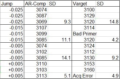

Well, having just finished loading up two ladders, I'm ready to load my gear in the truck and drive 8 minutes to the range for test 2.
First load is 33.5gr AR-Comp ~50k per QL. Second is 36.5gr Varget, also ~50k per QL, using four different jumps. -.0025, -.0015, -.0005 and +,0005 jam. I took a chance and soaked my SS brake in CLR for 20 minutes and it came out like new. Thoroughly cleaned off the residue and wiped it down with a light coat of oil. Kinda drizzly and dead still this morning but its supposed to burn off mid morning. I will report in once I get home. Just watch, I'll get these 87 Vmax'es dialed in just in time to run out of them. :rolleyes:
Hoot
Finally got clear of Dad duties, celebrating my daughter's birthday weekend. Since when was a birthday spread over 3 days anyway? Probably the same fool who came up with half birthdays...

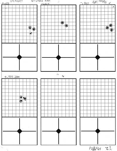

The faster powders (AR-Comp and Varget), did do better both in resulting groups and SD's. Wish I could say as much for my bench shooting abilities. "The older I get, the better I was".
Anyway, here's the data albeit a small statistical sample:
Here's the AR-Comp Target:
and Varget:
Quarter inch grid. After the first group, I thought "Oh Boy, Bus Riley's back in town!" That didn't last long however. Still, I'll take the bitter with the sweet. Couldn't believe I had a dead primer in the Varget run. I guess they're not so valuable that I need to pick them out of the floor sweepings without knowing how long they've been there. :rolleyes:

Dude, those are 1/4" to 1/2" groups and single digit spreads.
That's one of my barrels. I have no problem saying that. I mean dang... not bad for a $249 prefit. I would suggest a wind flag if you are not using one.
I would try .025" jump, .035, and .045 but you can use .025 jump and do a load workup now.
