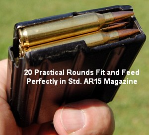

If is had to be an AR, the .20 Practical is a great way to go. But I did my time with ARs. Got tired of the cleaning, dings on the brass, and messing with magazines. I think with my ARs I spent an hour cleaning for every hour shooting. Waste of time. With my bolt guns, I spend maybe 10 minutes cleaning for every hour shooting.
