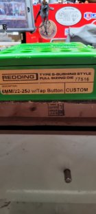

What dies are you using?

Sorry, I have Redding dies.

My 6-250 is for varmints…..12 twist, 0 freebore. Brass is Pmc 22-250 necked up and 250 Savage necked and turned. Date on my reamer is 7-96 so it’s been awhile. No dies available back then but you can improvise. 22-250 bushing fl die with 6 mm bushing works fine. Seater was made with Redding 6tcu comp die and slider rechambered to 6-250. Took some doing but nothing else available back then.
