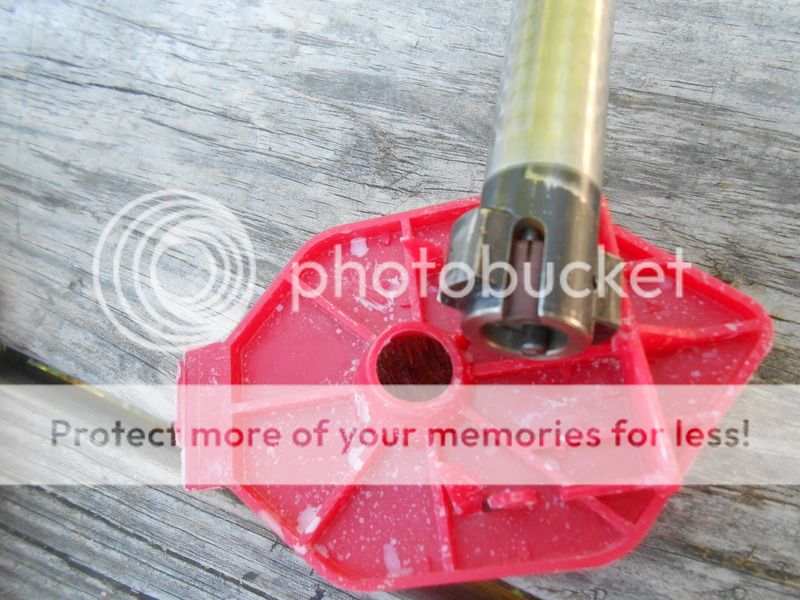

Pic of the extractor on my new to me ppc. I assume it's a sako, but they look about the same as an m16 extractor to me.
I was going to ask but then just decided that it would have the Sako extractor. I would DEFINITELY remove the ejector. No need to be flinging your highly fiddled brass onto the ground.
