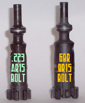

B.R.A.T. Offers 6BR and 6BRX Uppers for AR High Power Shooters
BR Armament Technologies (B.R.A.T.) of Saluda, VA is currently producing AR uppers chambered for the 6BR and 6BRX cartridges. Unlike some other previous AR conversions for the 6BR cartridge, the BR15 uppers produced by B.R.A.T. do not merely use a .223-sized bolt opened up to fit the .308-sized rim of the 6BR case. Instead B.R.A.T. employs a different bolt design that is bigger, and significantly stronger in the lug area. Shown below is a .223-sized bolt (left) and a BR15 bolt from B.R.A.T. on the right.
The B.R.A.T. BR15 upper receiver has been specifically designed to use the 6BR family of cartridges. It has a larger bolt, modified bolt carrier, modified upper receiver, larger barrel extension, and most importantly an all-new magazine designed specifically to handle the BR class of cartridges. All other parts are standard AR15. The folks at B.R.A.T. have developed their own magazines. These are 5-round center-feed dual column magazines that work with the 6BR, 6BR-derived cases (like 22 BR), and the 6BRX. Since the round feeds from the center, the mags can also be used for single-feeding.
