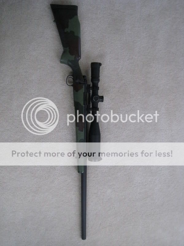

I'll be taking delivery of my 6mm Remington project shortly. It's an m40a1 copy,1 in 9 schneider barrel) to be used for prairie dogs and groundhogs. I have a supply of remington brass, fed 210's and a box of Nosler 80gr ballistic tips that I'd like to start with.

Thanks for the input, as it turns out it doesn't like the Noslers. However it shoots the Berger 80 g over 41.5 of 4064 into one hole at 100 yards, needless to say I've found my load. I'm getting 3450 fps out of this load. Bring on the groundhogs and p dogs!
