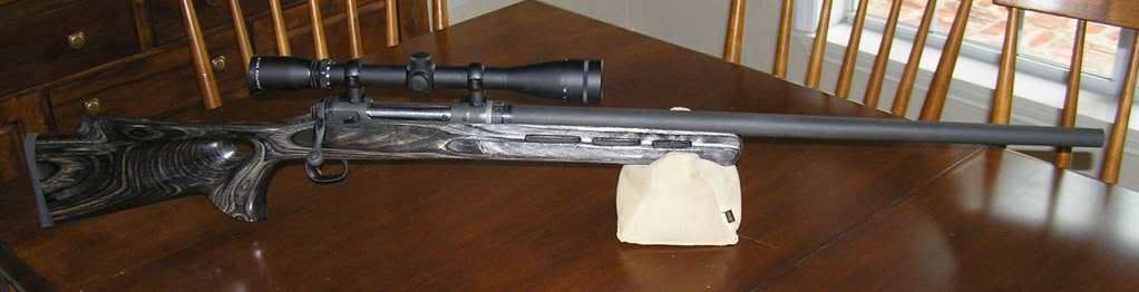

I would strongly suggest the long action for the 6mm Rem. I have owned 3 different Rem 700s in the 6mm Rem and none of them could be seated to touch the lands. I built a Savage around a LA Stevens as my first Savage project rifle. I have +10 barrels now for 2 different actions and I switch barrels routinely depending on what I want today. Here it is with a 28" 1:12 Shilen Select Match in a 6mm Rem SAMMI minimum chamber. I also have a 6mm Ackley Improved barrel for it in a 1:9 twist. It is now a 223 for my son to hunt with this season. LA all the way unless you only want to shoot the 70s and smaller. I made up a bunch of brass for my 6Rem using RWS 7x57 as parent brass. Much tougher stuff and you can drive a 75 gr VMax into the future it goes so fast..... well really I can get over 3650 fps with the 28" barrel.
