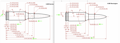

I came into possession of a 3 die set of Redding dies that are marked 6mm Rem BR.
I’m still a noob when it comes to precision reloading. I’ve never heard of this caliber. I have a 6BR Norma which I reload for.
What are these dies actually for?
Thank you!
The 6BR Remington has a couple minor differences, IIRC, case OAL is a tiny bit shorter. My Redding Competition Die set is marked 6BR Remington as well. I called Redding Tech Support quite a while back and was told they work for both the Remington and Norma versions.
Maybe this will explain the biggest difference (free bore), as the Remington version was designed around lighter weight bullets:

See reply #5 on the attached link.
I bought my set of Redding 6br dies last year and they’re marked 6 BR REM. I think that’s all that Redding offers. They work fine for my 6br Norma.
I queried Redding about the very same thing and they told me that though the box is marked 6 BR Remington that the dies were for the Norma version…
The primary difference between the original Remington 6BR and the Norma 6BR is the length of the neck… Ask me how I know,,,
