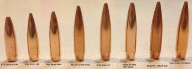

Here is a picture courteous of my shooting buddy Doug who will be testing the ammo in my absence. ( pretty good buddy huh?)
These are the bullets that will be tested sooner or later, In the 6mm FAT RAT
RussT
