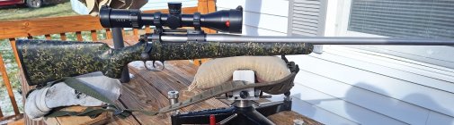

I bought a Remington 600 Tomahawk that came with a a 6x45 (6x223), with a vintage McMillan sporter stock. It also had a .223 barrel that was new and unfired for the same action. I had a 6mTCU decades ago when it first came out in a TC Contender. I never thought much of it 40 or more years ago. But a 14" barrel did it no favors!
When I first got this I had no dies or anything just a 223 S sizing die, so I ordered dies from redding, and put a .250 bushing the S die, and used the original owners seater till mine came. Using new LC brass, and a 65 grain bib bullet, I loaded some Benchmark loads. I never had Steller results with and put together 5 loads starting @ 27.0 grains to 29.0 in .5 grain increments.
Benchmark had given good results in my 222 and ppc, just not as good as other powders. So I wanted what the OP is looking for, a 300 yard walk around light gun varmint rig. I got it!! I think every one of those 5 shot groups I initially loaded would work. Everyone 1/2moa or smaller.
20241211_105158[1] full crop.jpg 3200 fps to 3300 fps was all plenty good, the 28.5 and 29.0 loads I only loaded 3 each because I wasn't sure about pressure, just to see. I settled on the 28.5 after reshooting it and staying in the .326 moa at 3290 fps 5 shot average, and said good enough! I'm sure it can do better, but this is a lightweight walk around varmint gun.
The 222 mag is in my opinion a better cartridge to work with, and with the longer neck, primarily the same powder capacity, I'm sure you will be happy with it. I even loaded 2 85 grain Sierra hpbt's and as you see on the top right target, same results as the 65 grain bullet! But this barrel is a 1-8 twist.
Had I built this to what I wanted for the cartridge, I think a 1-12 twist would be perfect for the 65 grain bullet. I think you could go as heavy as 65 grain but 70 or more with a 1-14 barrel would be less than optimum. But easily 3300 fps, and yes, 300 yards on ground hogs is easy with .3ish moa.
Better cartridge, better action, and 1-8 to 1-14 twist barrel, your going to have what you want!!
View attachment 1668881 3200 fps to 3300 fps was all plenty good, the 28.5 and 29.0 loads I only loaded 3 each because I wasn't sure about pressure, just to see. I settled on the 28.5 after reshooting it and staying in the .326 moa at 3290 fps 5 shot average, and said good enough! I'm sure it can do better, but this is a lightweight walk around varmint gun.
