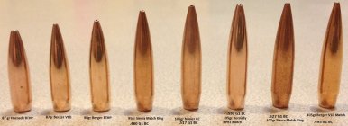

Check this out. A visual Comperison only, cant help you out with the G7 BC Maybe Bryan will post something pretty soon on that one.

Bill I believe he is asking about the Hornady 105BTHP Match bullet in my picture, The shinny one third from the left. Do you have G7 for that?

That was what I was thinking but not positive and this is why I specified that the BC I quoted was for the AMax.
