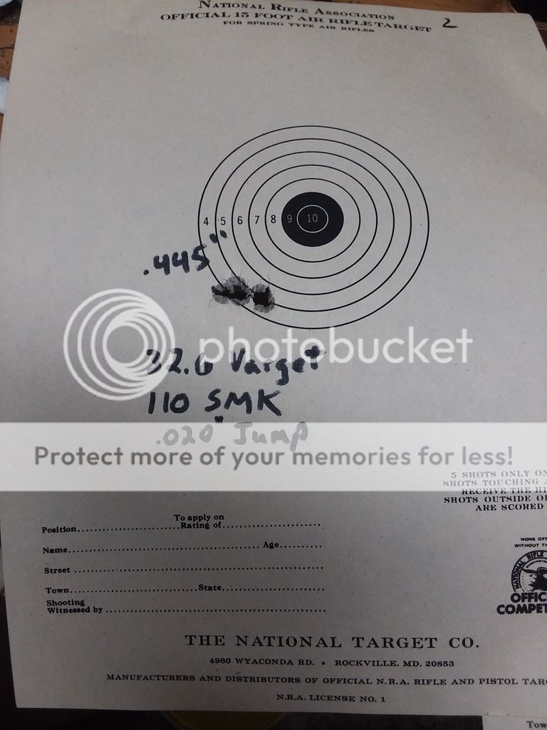

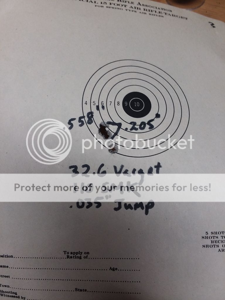

Would it be safe to say the next step would be to try the seating depth in the middle of these two loads?
I seem to be getting shots out low and right with this Dasher. Maybe I should try a ladder test at 300 yards?

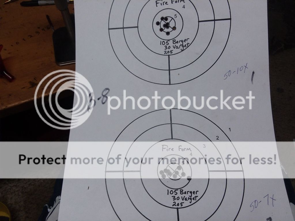

I get some two group stuff like the pic above if I let my front rest bag get loose or I bang the rifle back forward and hit the stop
What primer are you using? My groups looked like your last pic then I went to CCI 450 made a big difference.

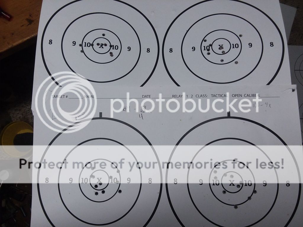

I think it may have been the wind, wasn't using flags and was rushing things. I threw out today's match targets,, but I'll post the last 300 yard targets I had at 300 yards which are very similar.
The thing is launching the 110's at 3000 fps no problem so I may just drop to 32.4 of Varget and the wolf magnum primers for the next match this Saturday and see. I need to get cleans and 30+ X's to be at the top of the pack.
Thats 2 totally different groups all together. Nothing relating one to the other. You already know you need some wind flags but i suggest you try more seating depths after you step the charge down to a less velocity node. Speed isnt everything and i think if those same loads were shot at distance it would show how wildly on each edge those are. If you get close you need to shoot 2-3 groups giving time between maybe round robin style so we can see how the wind changes are affecting them. I think youd have enough data from 3-3shot groups of each of those loads that you can tell something
