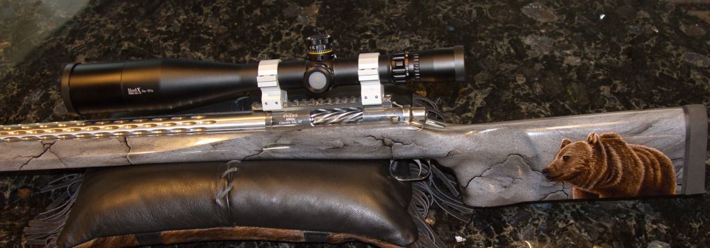

Just like my last DASHER:
Defiance Action RB/LP/bottom eject w/spiral fluted bolt and Picatinny rail
BRUX 29" SS barrel w/interrupted fluting
Chamber specs .460 shldr, .471 base, 269 nk, 103FB 1.555 length
Jewell HVBR-A trigger set at 2oz
Precision Rifle and Tool 'Low Boy' stock
Kelbly 34mm scope rings
March 8-80x56mm scope w/MTR1 illuminated reticle.
And, an awesome paintjob by http://www.madshadowcustompaint.com/ so if you don't shoot worth a crap you can at least look good doing it....
