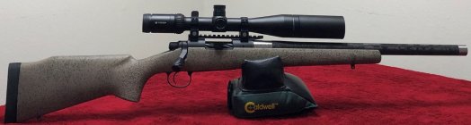

My 6CM is built on a trued Rem 700 with Proof Research 9tw 20in CF wrapped barrel.
That is almost the same setup I’m working on. It’s for a good friend of mine and for coyotes and critters. The rifle I’m working on is a rem700 20” Bartlein 8twist carbon wrapped.
