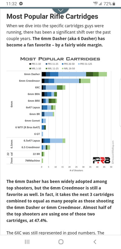

Any idea as to why the 6mm CM outnumbers the 6mm BR in top PRS and NRL competitions? I am still fairly new to this sport and just trying to understand as much as I can.

I really like the 6br and the 6 Dasher even more. But for PRS type of shooting the creedmoor may be the way to go.

Dasher is king!
