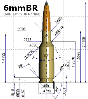

6BR 6mmBR 6mm BR Norma 6BR Remington blueprint diagram
6mmBR.com
Long popular in Europe, in the past few years the 6mmBR (6BR) cartridge has become much more widely adopted by North American shooters. It’s easy to understand why. The 6BR is superbly accurate, very efficient, and very versatile. A 6BR can set world records at 600 yards (and even 1000), yet it is easy to tune, and it is just as well suited for a long day in the varmint fields.
6BR shooters know this chambering offers great factory brass (Lapua and Norma), and a fantastic selection of short- and long-range match bullets. The 6PPC may be a little more accurate at 100/200 yards. But at 300 to 600 yards, the 6BR’s extra capacity gives it an edge, making it a very tough cartridge to beat. The 6BR remains the dominant cartridge in 300m competition and, thanks to shooters like Terry Brady, the 6BR holds many of the 600-yard BR records.
Here then, we have a cartridge that delights both varminters and match shooters–benchresters and position shooters alike. The 6BR offers easy load development, excellent barrel life (expect 2500 rounds or more of top accuracy), and low component costs. Despite its small size, the 6BR offers better ballistics than a .308 Win, though the 6BR burns 33% less powder and produces 55% less recoil. (6BR with 105gr compared to .308 with 175gr.)
Support Your Site
6mmBR Cartridge Basics
The 6mm BR that is most commonly used today is also called 6mm Norma BR, “6BR Norma”, or just plain “6BR”. This cartridge was based on the original 6mm Remington Benchrest case. Though there are very slight differences between the SAMMI spec for the 6mm Rem BR and the CIP spec for the 6mm BR Norma, the OAL case length is the same. We’ve observed that there may be small variances in base dimensions among production brass, from brand to brand. Though Norma standardized the round, most people shoot Lapua brass, because of its superior quality and uniformity, not to mention lower cost. The case capacity of Lapua brass is about 38-39.5 grains of H20, after fire-forming. The exact capacity depends on your gun’s chamber and the brass lot. The 6mm BR is one of the most accurate cartridges in existence, bettered only by the PPC type cases in group shooting, and the 30BR in score shooting. The 6BR is very versatile, capable of great accuracy with bullets ranging from 50 to 108 grains.

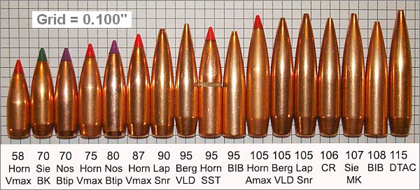

Best Bullets
For short range: 80gr Berger or Fowler FB, 74gr Berger FB, or any of the good 68gr custom bullets. We’ve had many reports (confirmed by our own testing), that the Berger 80-grainers shoot superbly in both slow- and fast-twist barrels, from 12-twist to 8-twist. If you want to see how tight that 1:8″ barrel of yours can shoot, load up some Berger 80s 0.015″ into the lands with a stout load of N-135.
For medium range or 1:10 twist barrels: Berger 88gr Low Drag FB, BIB 95gr FB, or Hornady 87-gr V-Max. The BIB is superbly accurate, having shot sub .2″ groups at 200 yards.
For long range: Berger 105gr VLD or the new 108gr Match, 100gr or 106gr Clinch River VLD, 105gr JLK (Swampworks), 105gr Lapua Scenar, 107gr Sierra MK, or 103gr Spencer. The value choice is Hornady’s 105gr A-Max ($16/100 at MidSouth Shooters Supply, #003-24562).
The Lapua 105gr Scenar is a very uniform bullet and ultra-accurate, but the max diameter is 0.24285, compared to 0.2433+ for some other brands. Accordingly the Scenars may prefer a tighter bore. They shot superbly in this editor’s PacNor 8-twist and a .236-land Krieger tested by Jackie Schmidt.

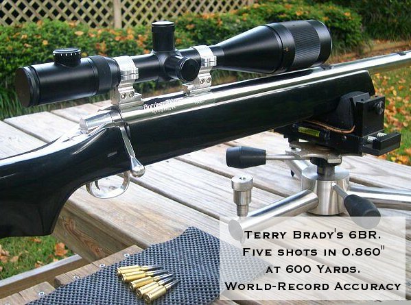

105gr VLDBerger30.4VV N540CCI 4502900+Terry Brady has set world records with moly version of this load (31.0 gr), and RL15 works too. Great bullets. High BC.
