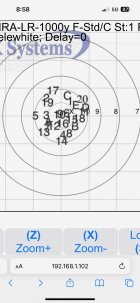

I had a blast shooting mine at camp Perry long range this year in AR-Tactical. 109 berger with too much AA-2520 gives me 2650 from a 22” barrel. I did shear a bolt lug around 1000 rounds in. Using a jp bolt now.

Park Ranger post #32 using AA 25-20 pushing 109 Bergers sheared bolt lug at Camp Perry.
Accurate Arms 2520. It’s a ball powder. Yes, Hornady says (and quick load) to stay at 28.1 grains for 52 ksi at 2600 fps in a 22” barrel. I was using 28.7 grains. It was too hot but shot good. I rolled the dice and lost.
