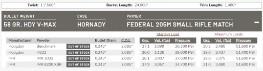

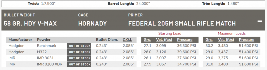

I'd say Benchmark, h322, and xbr for that weight range. 3350-3450 fps with 58 grain vmax in a 20".
But honestly the 6 arc is as you say designed for heavier bullets and really shines at the 87 vmax and heavier. Because of the reduction in suggested operating pressure in 6 arc you loose some of the potential of the cartridge that isn't made back up until you maximize the bc with the improved geometry of the shorter case in an ar15 platform.
A 223 wylde or 556 nato chambered ar15 can send a 53 vmax or 55 blitz king out at north of 3400 fps in a 20 inch barrel.
A light 6 arc has nearly identical trajectory and energy to a 53-55 grain in a 556 nato capable ar 15 with the same barrel length. I don't think the difference is worth it.
