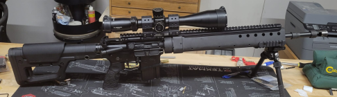

I’m into my load development for my AR15 6mm ARC Bartlien 26” 7.25 twist by Paul Craddock.
I’m resizing 6.5 Grendel using L E Wilson bushing FL die. I also anneal my brass.
