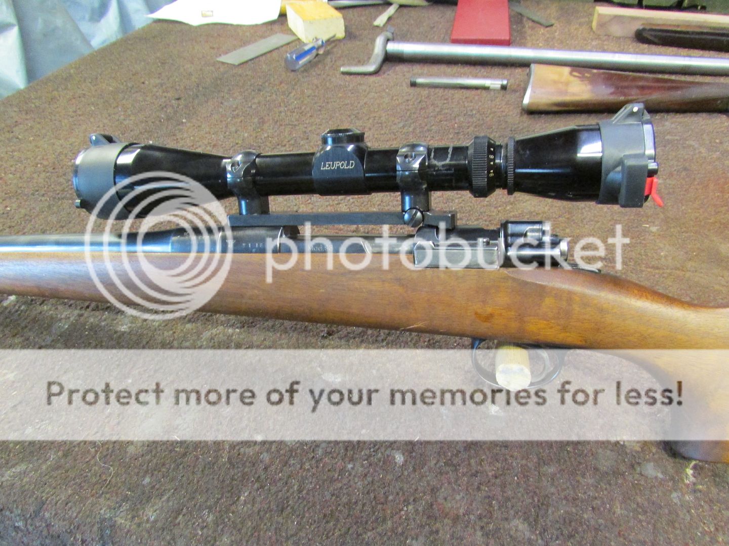

Sorry for getting so far off topic. I tend to wonder and will get back on track. Here are some pictures of my gift gun 6mm/284 Mauser 98. I'm going to take off the cheek piece, shorten the pull, reshape the stock and give it an oil finish.

And that 98 Mauser you've got there looks like it is all business!
