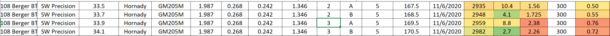

this is from various sources not my own....compiled to compare different 6mm offerings
The first two screenshots are the first rounds out of both of these barrels. Keep that in mind, as the velocities may be low. Both are 30" tubes.
30" Bart
30" Krieger:
30" Krieger: (these were 110 A-Tips, and were like rounds 75-105)
30" Krieger (Berger 108s)

Ahhh perfect, thank you so much!! I am running 115 DTAC in Hornady brass in a 25" barrel so it's not 1 to 1 comparison, but you have me a good starting point! Have you used Varget or H4350? How does SW Precision compare? I have never used Varget, all of my loads are with H4350 and I am getting good groups and speeds around 2860fps. But my ES is around 20fps and I want to get that down. I know the cartridge was developed for Varget and SW Precision is supposed to be very similar so I am going to try it.
I've used SW Precision in my 22BR. In my experience with that powder you need to drop about 1gr under Varget. Most fellas are finding a good load from 33 to 35grs of Varget, so I would try about 32 to 34grs and see what you get.
