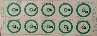

I finally made it up to the range for another powder ladder test. A few changes this time around.
front rest and rear bag, different scope so POI is different than the orig post but no elev/wind changes this target.
These are 3shot, .2gr steps (orig post was .3), aim was center for all.
There was no wind at all, the entire time dust rose slowly straight up. 68-72deg hum 40%, press 29.80, elev 100ft
no clickers but appears last four groups maybe very slight primer flattening, the last shot of 34.2 had cratering so I'm thinking that's right at max. There was cooling breaks after sighters and every 3rd set to keep temp consistent.
Any input is welcome. I'm thinking low end 32.2-32.6 or hotter 33.0-33.4 (similar to 7,8,9 first test) << this?
Thinking of moving to seating ladder at 33.0-33.4 and see what it does. good/bad idea? all wet?
After summer and some unforeseen stuff that kept me away from the range, finally made it out for the seating ladder. 3 rounds per group. I have to say I continue to be super happy with how this shoots, now to settle on a seating depth. Hoping to get some feedback on what I'm not seeing in these.
1-10 starts 0.003 off touch moving out to 0.030 in .003incr. There was no wind and shot at 100yrds. All
same powder load and foulers were shot before these. I shot these 1-5, then waited for barrel to be just warm, then 6-10.
They seem to be trying to repeat about every .009 but honestly I would start working inside the lands from touch .003 .006 .009 jam look for a .003 .004 window that doesn’t spit rounds then load to the inside of that.
.012 jump isn’t bad but each side 9 & 15 are moving so it’s a small window. Sometimes that’s all you get though.
@JFrank thanks Jim for your input, it's appreciated. -- Jeff
I'll give touch and in towards jam a try so I can see the results and also out from .030 a bit as when I'm running this from the mag I would rather not risk dumping powder so wanting something off for that and thinking testing more around .012 as that's where I was during all my powder testing. Might do that after doing the additional tests further in and out.
I'm now at 123 count on this barrel. Looks like it sped up about 11fps since last time although humidity today was about 15% higher, otherwise same same for temp, pressure. I recall folks saying humidity affects but I can't remember which way or how much. Regardless it's currently a pretty small increase.
@JFrank I do have bushings but hadn't used them yet. I'll keep that in mind. So far this is virgin Alpha brass all I've done is make sure primer pockets are consistent, chamfer/debur, and run a mandrel through em. So they aren't even fire formed yet and hoping they will only get better over time.
a seating retest where I did .003 in, and .030 out, skipped a retest of .012
I'm pretty sure .030 was me on that one, .039 pretty sure it didn't like it and spit that one out, no idea which hole third shot went into.
There was a little air movement and switchy, but maybe 1-3mph when it was noticed. Mostly the range had preseason hunters that were not properly schooled on either safety or range rules so while I wasn't ducking lead it was easily the worse range day I've experienced in the people sense. But hey only once did someone flag the entire line and only once did someone cross under the chain and out while hot! The other stuff was nothing in comparison. My point being, I'm claiming some of these might be me being distracted... I'm really liking how my powder load is holding up regardless of cold/fouling or not. In general regardless of seating seems really consistent but this is still just 100yrd. Likely see how it performs on the 300yrd range next.
Anyhow any comments, critique, suggestions welcome.
