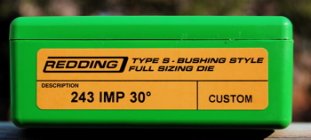

We also have dies for the 243 Imp 30 (see pic below) and the 6mm Super LR see here
http://www.6mmar.com/Super_LR.html

Donnie,
Who makes dies for the CM????
Are they a custom deal???
Can(do) you use Lapua brass in the CM???
What kind of case forming is involved???
Phil.
Phil, Redding makes the Die and it is Custom.
You can use Lapua Brass but you will have to turn the necks, if you use Win. you don't have to turn.
Easy to form, use the false shoulder method.
