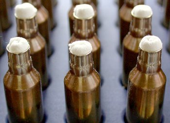

Anyone use- a charge of pistol powder, cream of wheat/ Corn meal and alittle crisco to keep it all in to form their improved brass for 6mm? I use it on my 260AI and it works great.

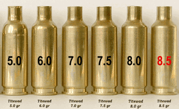

There was a thread with nice detailed pictures which demonstrated progressive charges of Bullseye if I remember correctly. Very nicely done. That thread would make a nice sticky. I would like to further my knowledge on this subject as well. The guy fireformed in his basement during the winter.
Here is the Bulletin item on fire-forming with pistol powder,Titewad), Cream of Wheat, and a tissue paper wad:
http://accurateshooter.wordpress.com/2009/06/14/tech-tip-fire-forming-with-pistol-powder/
NOTE the false shoulder in the cases prior to fire-forming:
There are some who feel that the COW fireforming method causes barrel erosion. I use the method with great success, but in a dedicated fireform barrel
