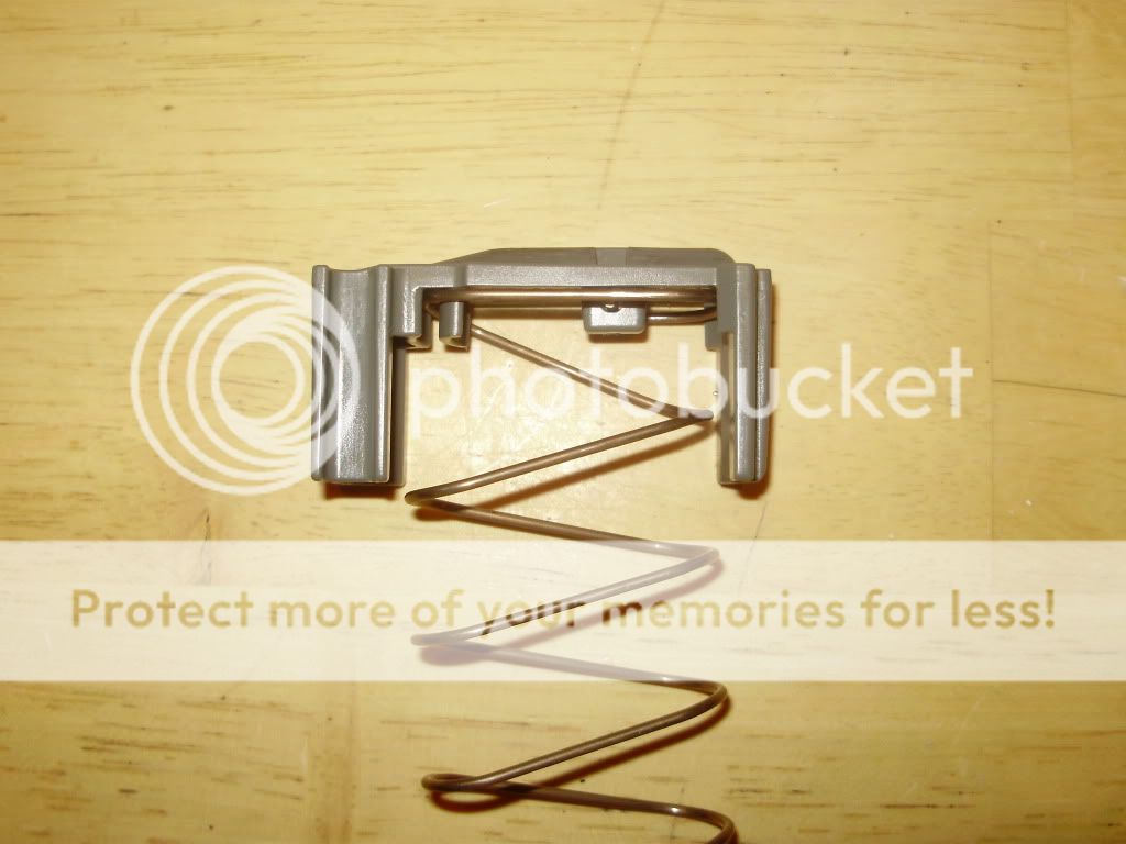

if the follower is nose diving take a look at the spring. When held straight up if the only thing touching is the center hook of the spring bend the front loop just under the follower up so it supports the front of the follower like this.
