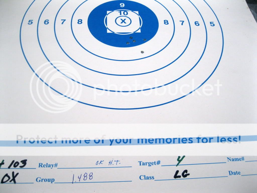

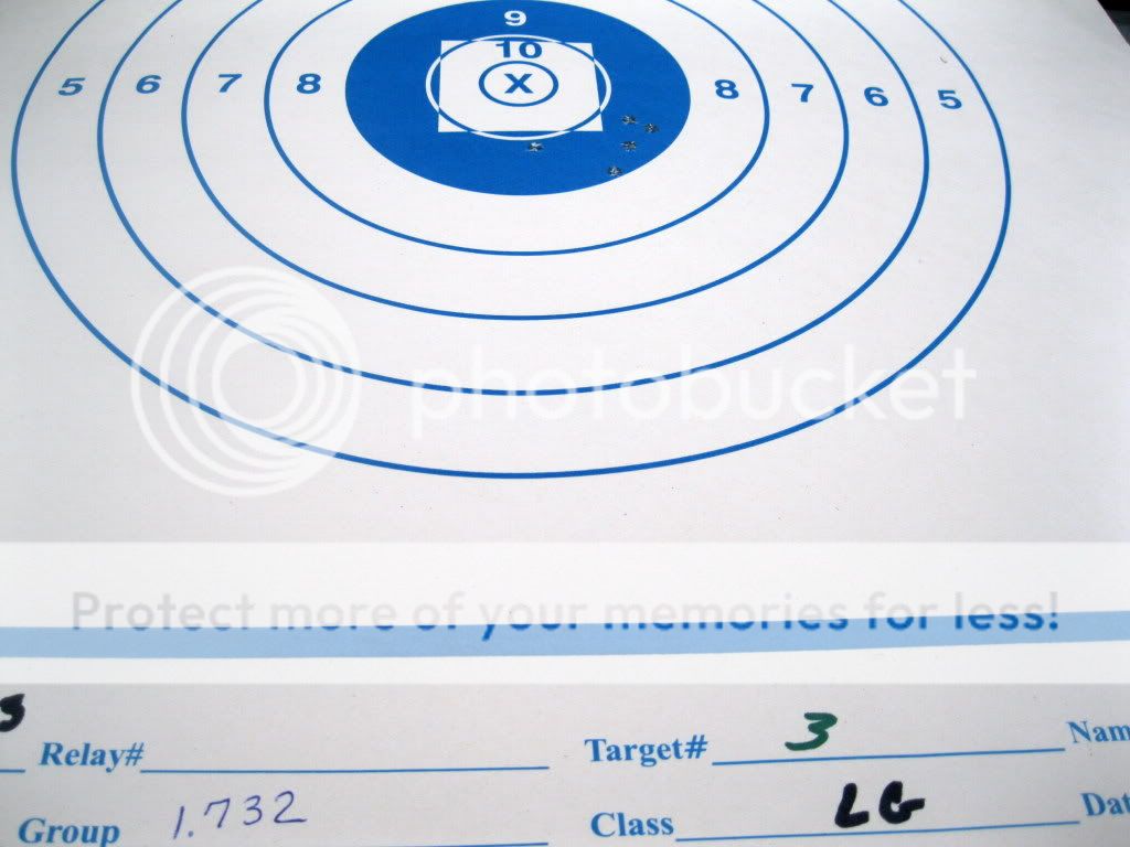

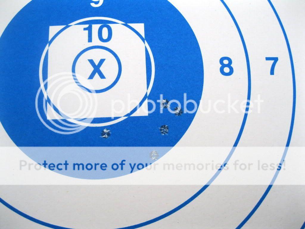

I can scratch of one of the priorities on my bucket list. We shot our monthly match here in Memphis at our awesome range MSSA and I agged my targets afterwards as we only shoot score in our club matches. I shot 6 targets Sunday and agged all 6 and was some kind of happy when I saw it was a 1.677" 6 target agg. That Bartlein and the .140" FB BRX reamer are a good match. Shooting Varget with Berger 105 VLD`s. I had never agged under 2" before in my life. Sure was nice to do it at home the first time.

Thanks for the report. That indeed is an impressive Agg. I'm happy whenever I can get a single target under 2". You obviously have a great-shooting gun. Post a pic or two and maybe I can make a Bulletin "Bucket List Accomplished" report on this. Again, thanks for sharing.

I was late to work posting the picture and left the worse one out. There is a 2.088" hanging out left field with the let off I missed. ::)
