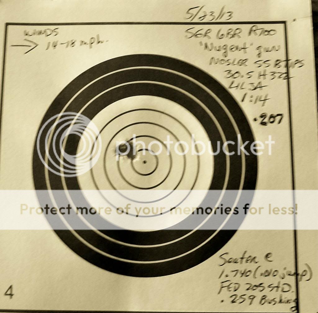

If you'll excuse the fuzzy pic, you'll get the idea:
In my experience, the 55's like a slightly 'faster' powder than you might think, due to the short bearing surface of the Nosler 55's and VMax 58's. I've also had good luck with Benchmark and Re7...depending on what the barrel likes. The short bearing surface bullets tend to like more of a jump than a jam, at least in my 6BR and the others I've tinkered with. Seating depths of .030-.040 'jump' from just touching have worked well. My own 6BR has a Lilja wide land 3 groove barrel and it wants the bullet closer to the lands.
In short, make sure and work with seating depths with the short/light bullets in the 6BR.
For what it's worth.... -Al
