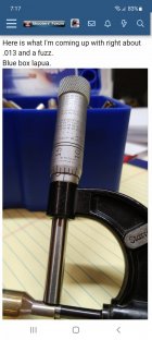

Well I've already turned them now and didn't make any notes. I can tell you I hate turning brass and wouldn't have unless I felt like I had to. I'm thinking it was about 271, but I don't trust this old man's memory too much. Sorry not to be more help.
And I'm not running down the brass at all. I just wouldn't get a reamer ground without having some in hand.
Even the big 3 manufacturers are all over the place on neck wall thickness. Either buy 500 pieces of brass and have JGS make a Reamer or go with a 273 for BR and be sure..
