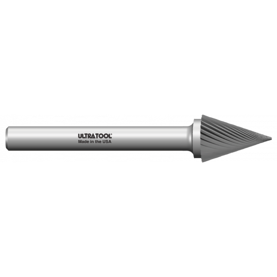

The first is how you are chamfering the inside case mouth. The cheap neck deburr tools sold for this purpose do not in my mind have an ideal cutting angle and worst yet, they are not sharp enough to do a really nice job of it. I've been using 1/4" shank cone shaped carbide burrs to do the inside and feel it is a game changer for how it improves seating pressure.
If you do this lightly after stainless media tumbling you will not have any problems with dented case mouths.

Not too keen on that carbide burr as it is really easy to remove too much material and the chamfer will be still too acute. Perhaps chamfering the case mouth to a knife edge if used too vigorously.
I would recommend the K&M tapered case mouth reamer inside, only about 17* taper and the cutter blades are sharp as a serpent's tooth and make an easy job of it. Also the cutter is depth adjustable and centres with a long pin/rod through the flash hole.
